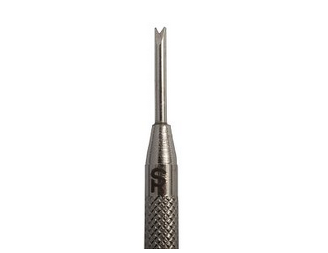

Step 1 - Buy a Spring Bar Remover Tool
We highly recommend using a spring bar tool to install or remove a 22mm band. You could try to use a flat head precision screw driver, but chances are you're going to damage your watch and/or scratch your brand new leather band.
Sometimes you can find spring bar tools at your local jewelry shop, but most do not sell them. Simple reason, they want you to pay them to replace the band on your watch! The best place to buy the tool is Amazon, this is the one we used for this guide:

This is when you realize how important the spring bar tool really is. Because of the V shaped end, you're able to grip the spring bar much better. Pull the leather strap back on one side to uncover the spring. Then using the tool pull the spring back until you can release the band. Repeat on opposite side. This step may take a few tries, be patient and gentle!
